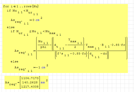

Don't worry; vectorize() is intended to apply to all the vectors' elements functions normally intended to work with scalars without using loops. In your case you have 2 ways:
1) use the loop; in this case vectorize() is not needed, remove it and everything should works
![2016-08-07 10_21_27-SMath Studio Desktop - [Documento1.sm_].png](/zh-Hans-CN/files/Download/FTUWaw/2016-08-07-10_21_27-SMath-Studio-Desktop---[Documento1.sm_].png)
2) use vectorize(); in this case you have to remove all the references to the matrix elements. Note that in your case you have to pre-process or post-process the elements where Mu doesn't meets the requirements
