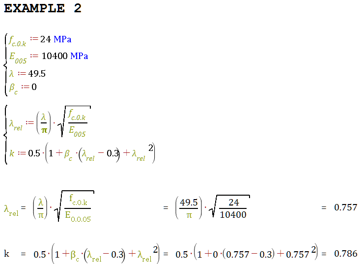

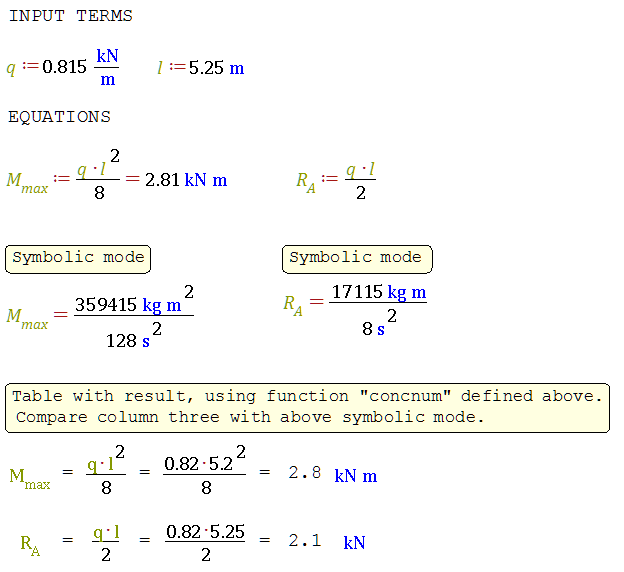

I have been trying to display the numbers in equations for a while now.
After experimenting with the table extension, I think I have discovered a method.
It is far from clean, and requires some manual input, and therefore is not feasible for one-off documents.
Yet, when reusing recurring documents that will be checked by others, this might useful.
Theres plenty to improve. For example, a function returning the defined content of an equation, without variable substitutions would really help.
*See updated file in last post*

No, Jean, that is not what I am attempting. The formated label combines values and does not work with units, similiar to symbolic mode. Since you often refer to mathcad, this function is similiar to the matchad explicit function.
Here is an updated version, now working with more equations
File:
example.sm (35.42 KiB)已下载 1379 次。
