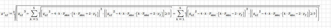

hi Folks, I am programming some equations and there is a requirement for a summation of terms, each term being a square root of a function of several variables. The method requires ignoring any negative results, i.e. where the square root of a negative number will lead to a complex number.
The terms are all have identical variables and it would be ideal if I can perform some operation on the general case term, so that the imaginary results just vanish.

hi folks, thanks for your contributions
the way I've solved my dilemma was to multiply each term by (X>0) so that whenever X is less than zero the sqrt(X*(X>0)) becomes zero.

Your description is too general w/o the formula.

So, you can define your own function pow3(x) = x^3 * (x > 0). Or maybe more general some CheckPos(x) for make more readable your expression.
