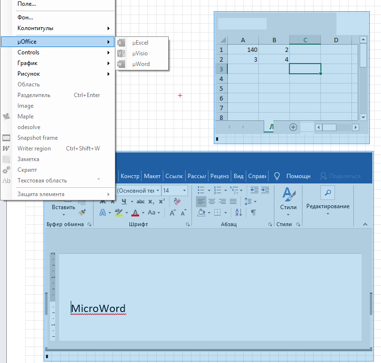

MicroOffice [ β ]
SMath Viewer compatibility mono compatibility Sources
Implementation started.
I don't know how, but I think it is possible to show office documents as images. For editing we can open Word, Excel or Visio as external editors. Documents can be embedded to worksheet.

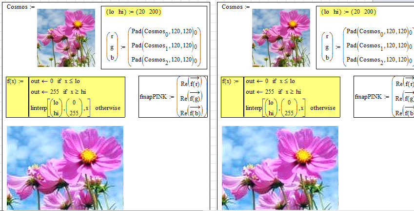

#6 已发布: 2019/9/29 19:48:04
983个赞,共6,866个帖子。
But if you make pdf from smath file which has image copied Excel table, quality is a disaster.
The two PDf look same [I checked both]
That's why I suggested NOT use Microsoft.
If I make an Smath PDF as captured, PDF is 1/1
My PDF is CutePDF freeware, NOT Smath PDF.

#10 已发布: 2019/9/30 10:16:06
1,558个赞,共1,868个帖子。
Is there any way to show the office document as objects, not as images?
Unfortunately, no. As I know for good quality you must use .Net graphic library and there is no simple way to translate graphics from another application. In such projects, I try to find ways to use the existing code to expand the functionality of the program even if the quality of the document decreases. There are so many components that are based on the Control class, it would be great to use at least some of them. Because writing a useful plugin from scratch is very difficult.
overlord 2019/9/30 15:15:00
#11 已发布: 2019/9/30 11:10:48
983个赞,共6,866个帖子。
Please zoom in both pdf. You will see they are not same.
Your last example has the same diseas, if you zoom in to your cosmos.pdf you will see.
Texts in cropped images are not looking good at pdf and paper.
At right is the original in Smath document.
At left is the 100% Adobe, copied/pasted.
#12 已发布: 2019/9/30 11:18:02
983个赞,共6,866个帖子。
Smath document.
PDF Cosmos Test.sm (711.28 KiB)已下载 1778 次。
After this post, I will re-download check.
#13 已发布: 2019/9/30 11:30:01
983个赞,共6,866个帖子。
... re-download sanity checked confirmed 1/1.
Conclusion:

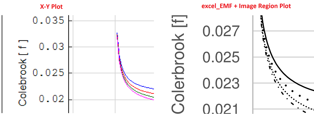

#19 已发布: 2019/10/2 15:43:06
Alexander O. Melnik
Alexander O. Melnik
127个赞,共498个帖子。
Jean, it is obvious you didn't check the pdf files. You really wouldn't need to tell me about how to crop images if you did, I already did that.
Problem is not how to do it, problem is font render quality. Smath copies excel tables as images, which has no font so no print quality.
1. there is undeniable quality difference between cropped image version (smath), which you mentioned, and font version (mathcad).
2. windows has its own screen capture program that works perfectly. no need to install or keep additional software for this purpose.
3. you actually don't need any software to copy image of excel tables, Ctrl+C is enough. than you can paste it as an image in smath.
But if you make pdf from smath file which has image copied excel table, quality is a disaster.
EXCEL I/O plugin will plot regions of excel for you without quality loss by using excel_EMF(#) function
https://en.smath.com/forum/yaf_postst4375_Plugin---EXCEL--2003--I-O-with-recalculation-and-export-to-PNG.aspx
A sample of a Plot produced by combination of excel_EMF function and Image Region inside the SMath workbook.
The example was borrowed from one of the calculations by Jean Giraud.
Note the difference of as-printed quality between X-Y Plot output and excel_EMF output.

#20 已发布: 2019/10/2 18:36:35
600个赞,共1,381个帖子。
This has much more render quality than I expected, actually there is no quality loss. Thank you very much.
If combination of excel_IO and image plugin can do this, there should be no reason MicroOffice plugins can't imho.
Smath can even store excel data embedded in *.sm file and it can be viewed without quality loss like your example.
So there won't be any need for an excel file (as a source) for viewing.
