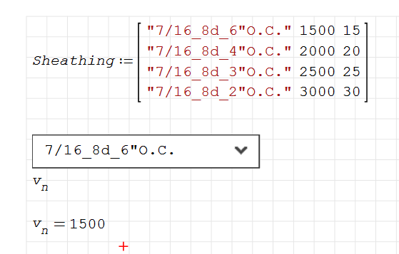

Hello all,
I'm a new member of SMath. Im wondering if it is possible to use combobox to return multiple values from a matrix. Ive attached an image below as an example. If I select 7/16"_8d_6" O.C. I want to have both the 1500 and 15 value return without having to make multiple comboboxes.
Thanks!
