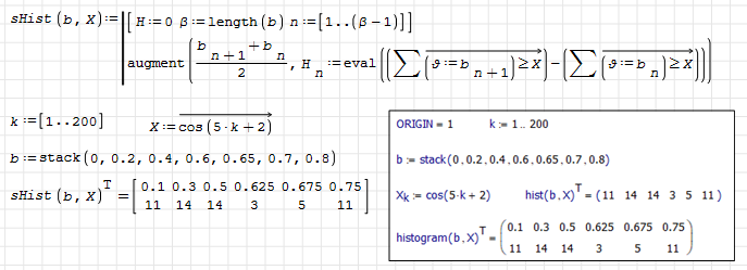

Hi Valery. This function returns the same result as mathcad.

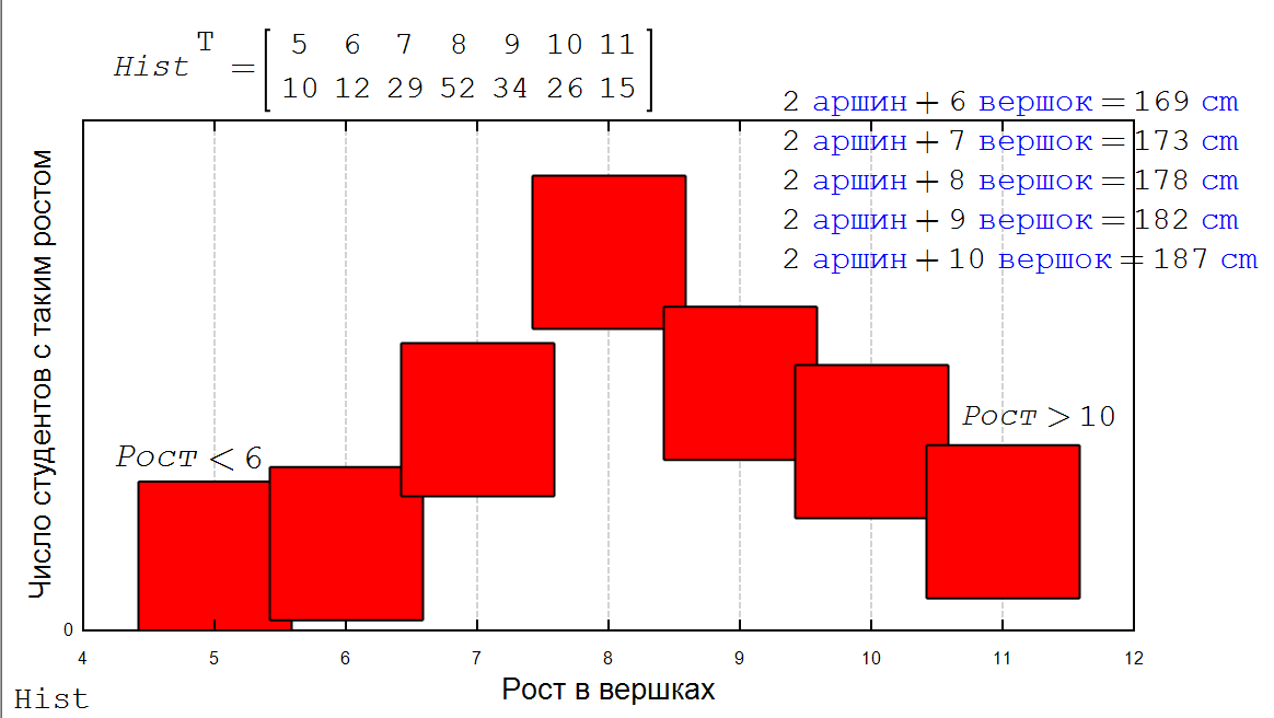

#3 已发布: 2023/10/11 05:25:07
Valery Ochkov
Valery Ochkov
67个赞,共716个帖子。

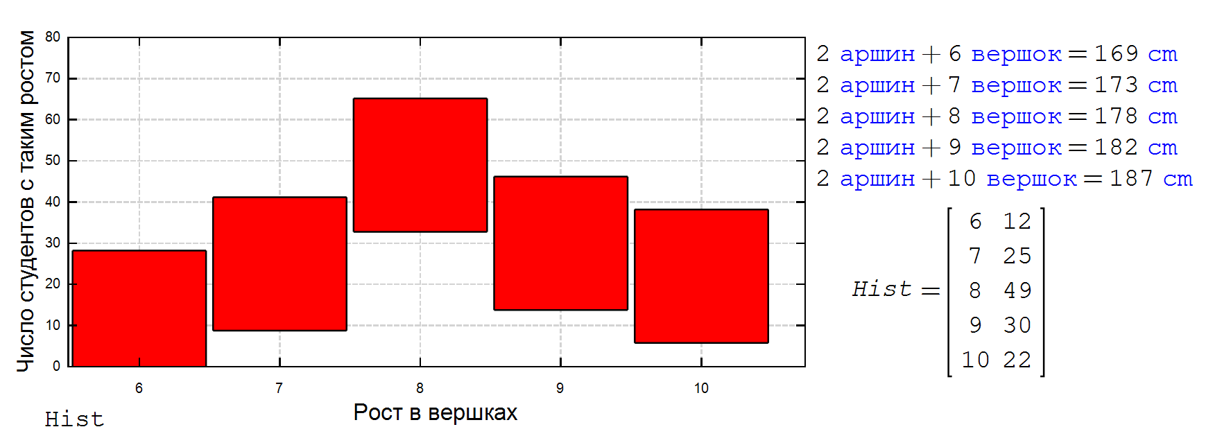

My students histogram
#4 已发布: 2023/10/11 07:42:53
1,362个赞,共2,276个帖子。

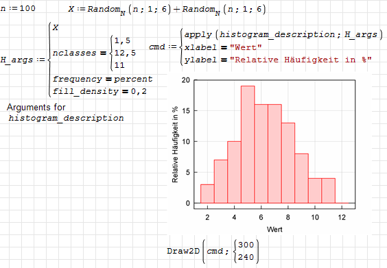

Maxima has a histogram plot function.
Taken from DOI: 10.25933/opus4-2949. The PDF has attached SMath documents.
2位用户喜欢此帖子
Valery Ochkov 2023/10/11 20:23:00, Oscar Campo 2023/10/11 09:42:00
#5 已发布: 2023/10/11 07:43:22
StvMath
StvMath
44个赞和1个踩,共76个帖子。
Are you looking for something more ;like this?
未找到文件。未找到文件。
#6 已发布: 2023/10/11 14:43:40

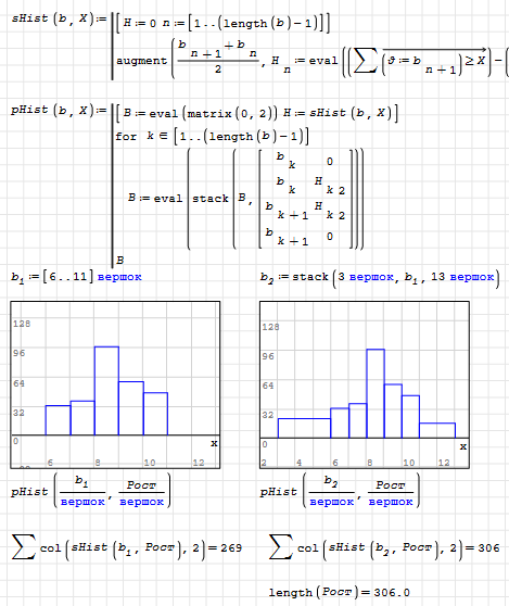

1,139个赞,共1,805个帖子。
Hi. This version also works with unequally spaced bins.
pHist Mister-Class.sm (61.58 KiB)已下载 1475 次。
Valery Ochkov 2023/10/11 20:24:00

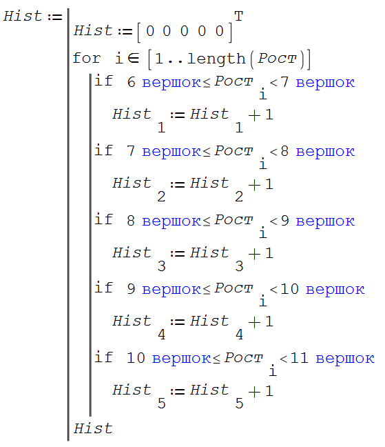

My KISS Histogram

Hi. You can use the above pHist within XYPlot.
