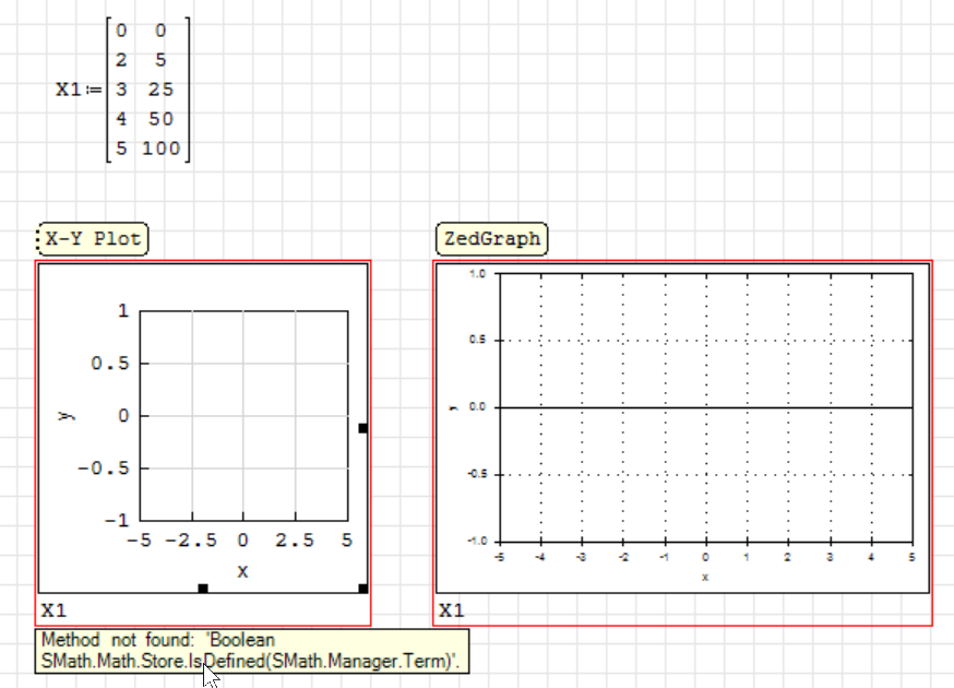

X-Y Plot and ZedGraph do not work in 5990 even after clean installation,
but was OK in all previous versions.
XYPlot, ZedGraph Error.sm (30.63 KiB)已下载 1384 次。

X-Y Plot now works. Thanks for the update.
ZedGraph still to be updated.

ZedGraph is updated now as well.
Thank you!
