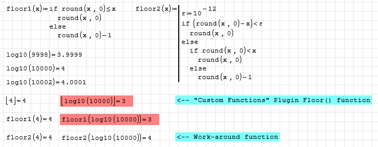

For all numbers 100 to 999, I want the function to return "2"
For all numbers 1000 to 9999, I want the function to return "3"
And so forth.
Since log10(100)=2 and log10(999)<3
and log10(1000)=3 and log10(9999)<4
I thought that "floor(log10(n))" would work.
However, the implementations of floor that I tried, do not return the correct value for integer powers of 10^x. As shown in my example.
-Jeff
#4 Posted: 2016/11/2 19:50:50
1,441 likes in 2,932 posts.
I think I found another quirky behavior.
It is because SMath returns 3.9999999999 (set the region to display 15 decimal places)
Let me explain what I am trying to accomplish. Maybe there is a better method.
And so forth.
Until is not fixed you can try with OoM(...) (order of magnitude) from Custom Functions plugin.
