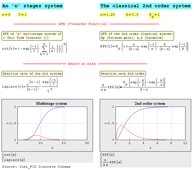

SMath论坛 SMath Studio Samples XFR & Rate 1页(1条) XFR & Rate - XFR & Rate - 消息 转到最后一个帖子 #1 已发布: 2016/6/25 11:44:07 Jean Giraud 983个赞,共6,866个帖子。 组: User Experimental didactic. Collect samples of the XFRthen model the XFR and conclude for the "Rate plot" JeanInst_XFR 2nd [XFR nth].sm (13.56 KiB)已下载 1356 次。 1页(1条) 有新帖 无新帖
