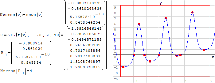

Non iterative methods for root estimation + iterative methods based on the sign(1) function for finding roots and maximum/minimum values in a range.
Signum-based Iterative methods.sm (185.41 KiB)已下载 1608 次。
2016-05-16 17_40_31-SMath Studio Desktop - [Signum-based Iterative methods.sm].png
2位用户喜欢此帖子

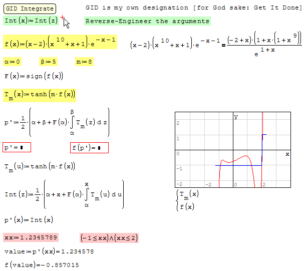

Thanks Davide ... that will make my day !
I discovered the "GID" transit integrator in Mathcad 11.
Works as well in Smath. Don't know if other CAS support ?
Then: like this

... p'(x) takes a while to plot.
Integrate GID Signum.sm (15.22 KiB)已下载 1535 次。

... in your last example: there is a missing 0 and an extra min/max
Davide Carpi 2016/5/16 12:42:00
#6 已发布: 2016/5/16 12:47:09
1,443个赞,共2,936个帖子。
True, thank you Jean
Usually it may need to play a little with bounds and intervals. In this case changing intervals from 40 to 41 fixed the issue. (updated the first post)
