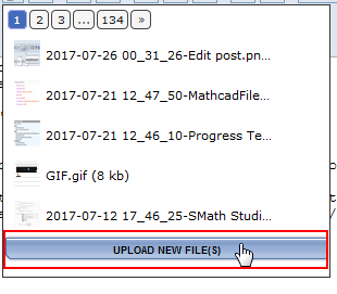

About the attachments, there's a button in the post editor, click it, then choose "upload new file(s)" and finally when you're done "start upload(s)"

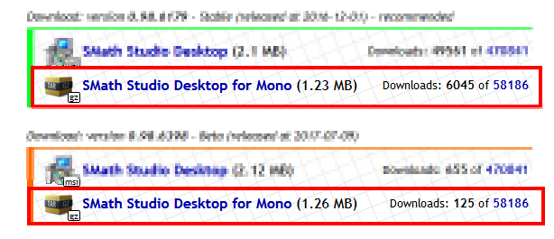

Hi, would you have a link for dowloading SMath for Linux please ? Unable to find it.
Here: http://en.smath.info/view/SMathStudio/summary
or here: http://en.smath.info/forum/yaf_postst7879_Stable--SMath-Studio-0-98-6179--01-December-2016.aspx
You have to install mono first, in order to run the executable!
