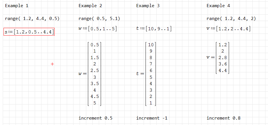

I am studying with Introduction to the use of SMath Studio Prepared by Gilberto E. Urroz, May 2010.
I don't understand something in ranges and would like some explanation.
Example1 is a definition error, and I'm curious how increment is defined in examples 2-4.

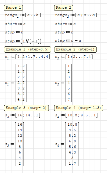

I hope picture below helps to clarify.
Regards.
