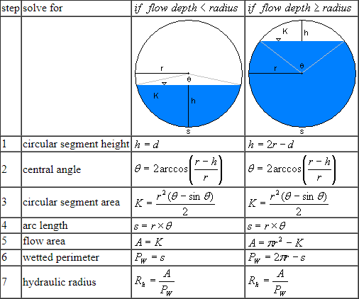

Anyone have a good description, write-up, or weblink that derives these two formulas? (Not Wikipedia)
As promised above.
This made Manning so much easier. Thank you all

Anyone have a good description, write-up, or web link that derives these two formulas? (Not Wikipedia)
Wikipedia has turned about useless in too many search !
Visit this site + calculator.
https://www.ajdesigner.com/phphydraulicradius/hydraulic_radius_equation_pipe.php
