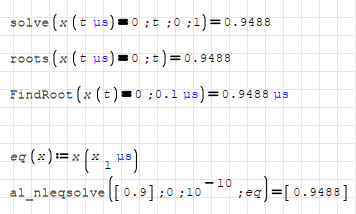

Hi Elis02,
Native solve() is nota robust solver, so it's convenient use functions as Solve() from Maxima plugin or FindRoot() from Non Linear Solvers plugin.
You need provide a value to x(t) for asking for a value of t that satisfies the equation, in the form "x(t)=k, t" where k is the value you expect obtain when replace for t:
Best,
Oscar
Best,
Oscar

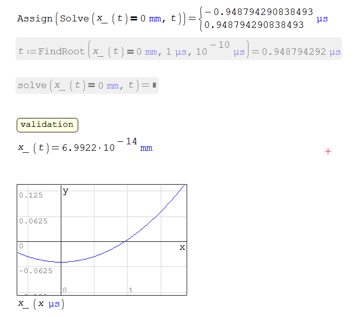

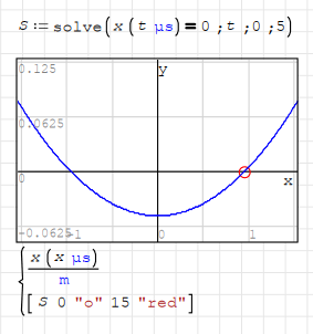

Numeric solvers don't like units.
Either don't use them or add units to solvers.
Entering a range/interval will help for solve().
Findroot() won't need unit addition btw.
test_s_math_solved.sm (12.16 KiB)已下载 1464 次。
2位用户喜欢此帖子
3位用户喜欢此帖子

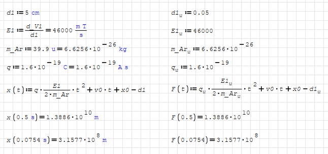

Windows handles arithmetic [+,-,*,/] in the range 10^ ± 307.
Your ^-19 is so small that the quadratic term vanishes.
What's left is the linear term and the shift system.
On the other hand, some function may be granular.
Granular in the sense that they many not compute exactly.
The one best known from Mathematica.
WroteWindows handles arithmetic [+,-,*,/] in the range 10^ ± 307.
No it doesn't vanishes.
You are simply not capable to work with units.
Anything involves physical quantities, you are wrong there.
This is not the first you act like a buffoon.
You couldn't write a simple formula, admit it.
In fact, you are a horribly wretched engineer.
Jean, look and learn. This is how you eliminate units.
Btw, why did you delete all your meaningless replies?
Can you see the problem Jean?
You forgot your unit conversions.
m_Ar and E1 needs magick numbers in your approach.
If you would capable to work with units, no coefficients needed.
Everything is simple, clean, easier to apprehend, much easier to manipulate with units.
