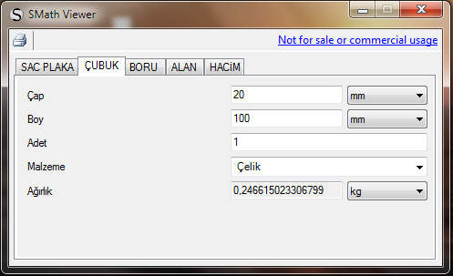

Is it me or SMath Viewer evaluates results with Decimal Place setting not considered?
Smath Studio is fine with it, but Viewer show results which has maximum possible decimal places.
