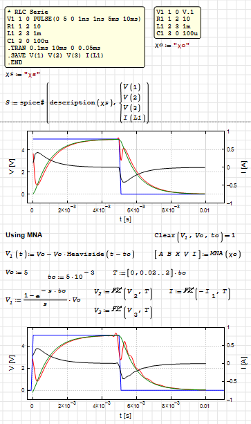

SpiceSharp (Spice#) - electronic circuit simulator
SMath Studio compatibility History page Sources
Based on SpiceSharpParser (.NET library that allows to parse SPICE netlists and to simulate them using SpiceSharp library).

Hi. A preview for exploring this powerful plugin.
spice# and MNA.sm (577.69 KiB) downloaded 1576 time(s).
spice# and MNA.pdf (1.5 MiB) downloaded 1411 time(s).

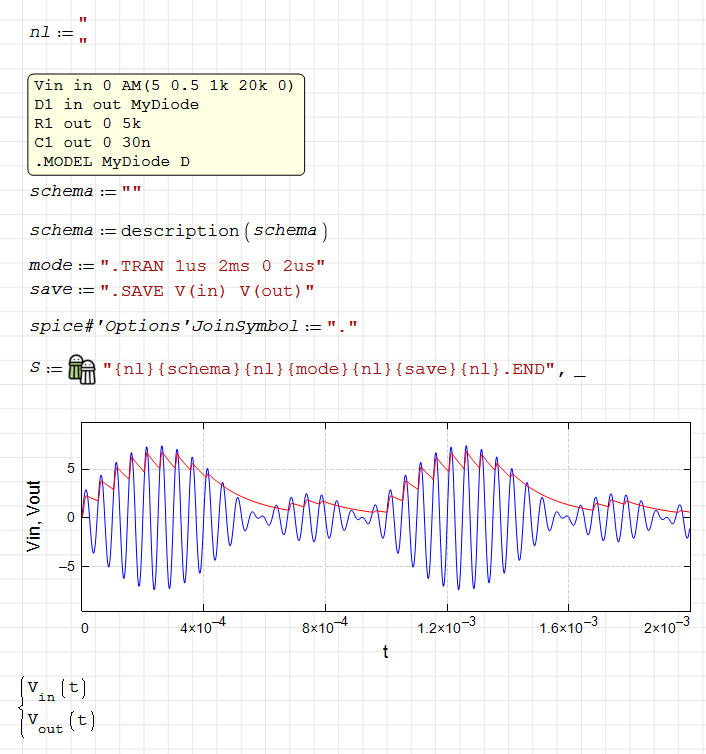

I haven't even tried these features myself yet. Support for all types of analysis hasn't been tested. There's still a lot of work to do. Maybe I'll do a direct insertion of values ​​into the circuit description. I wanted to try making a circuit with an amplitude detector. The authors have recently added the ability to specify an amplitude-modulated signal. They have a shell (GUI) in which you can also test circuits.

Hi Viacheslav. As far as I could see, the plugin you created works very well, it just has some very minor details, like not recognizing either "u" or "μ" for micro. By the way, handling that is a configurable option in ltspice. So you shouldn't be the first one to have problems with that.
As for the analyses that spice# has, it's just a matter of discovering them, since the documentation they have is very little, and for example, I don't know what convention they followed to enumerate the nodes of the controlled sources. I took the one they use in the Qucs simulator, but there is no standard for that.

New version, more compatible with spice# sintaxis.
spice# and MNA v2.sm (636.64 KiB) downloaded 1522 time(s).
spice# and MNA v2.pdf (1.63 MiB) downloaded 1238 time(s).

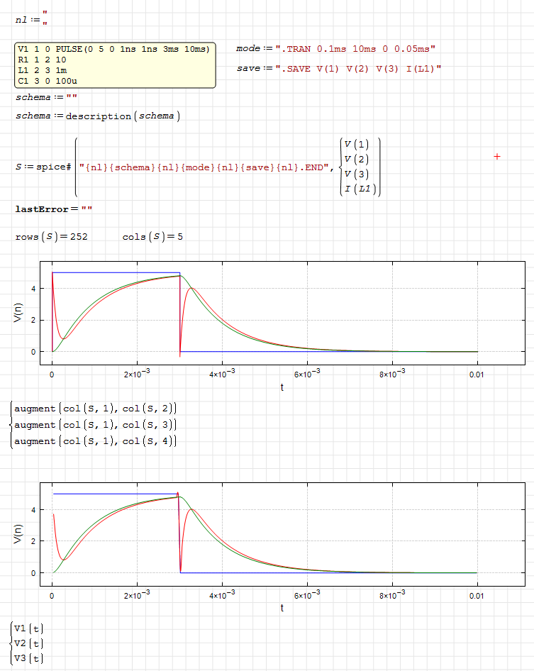

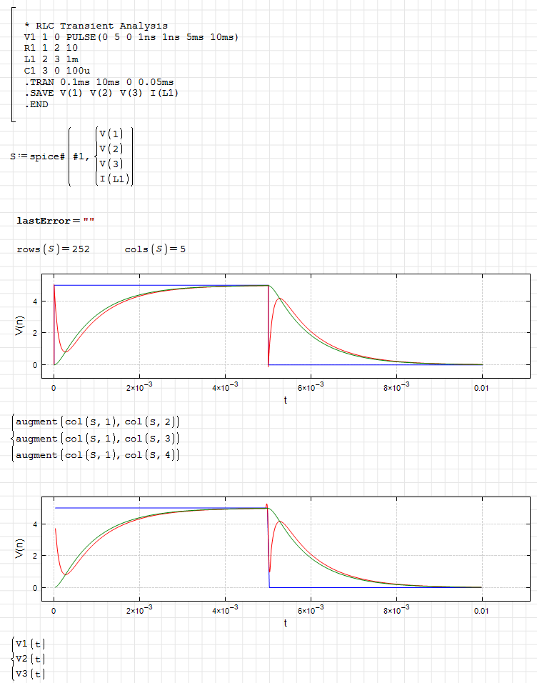

Plugin updated. [BETA]
Changes:
- expanded capabilities of spice#() function.
spice#-tran-example01.sm (10.7 KiB) downloaded 849 time(s).

#12 Posted: 2025/9/11 15:34:13
1,544 likes in 1,859 posts.
spice#-tran-example02.sm (11.84 KiB) downloaded 848 time(s).

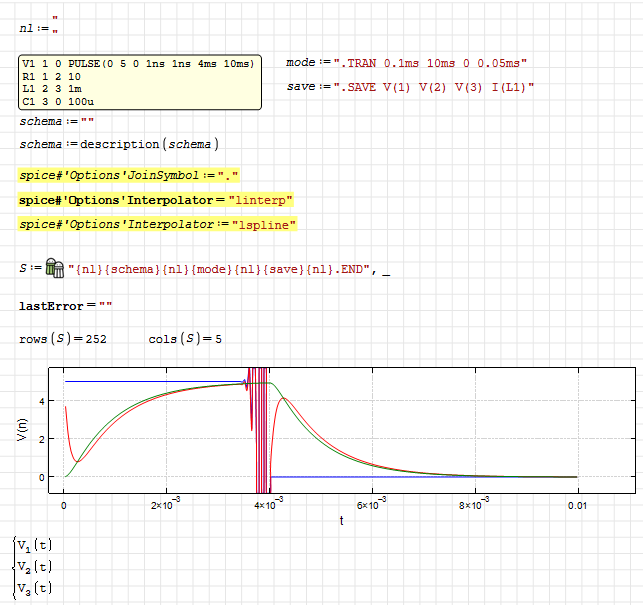

SMath Studio compatibility History page Changes AI Assistant
Plugin updated. [BETA] 🤪
Changes:
- Custom Icon/Glyph Rendering
- Automatic Export from .SAVE Statement.
- Automatic Interpolation Function Generation.
spice#-tran-example03.sm (11.78 KiB) downloaded 847 time(s).

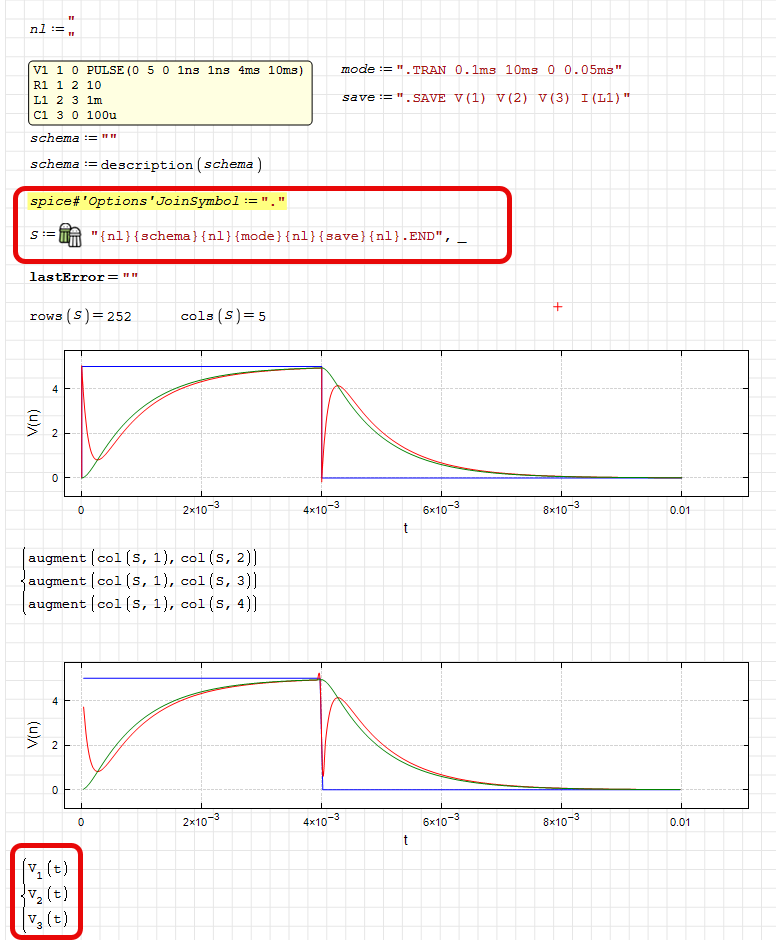

Changes:
- Refined Glyph Rendering;
- Added "spice#'Options'Interpolator" Operand.
Edited 2025/9/12 17:05:27

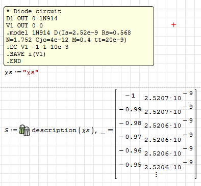

Hi Viacheslav. Great work, congratulations. Some questions:

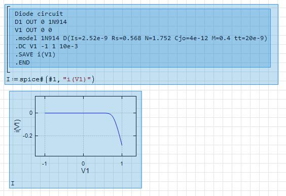

I was able to introduce an ampop, which is a fairly theoretical model without many physical parameters. How did you introduce the diode model?
I can tell you how to proceed, i.e. the algorithm for setting the problem.
If you want to simulate the scheme, then you need an example. Nowadays, in the programming world, it is common to accompany source texts with tests. These tests, as a rule, cover many typical tasks.
You need to find these texts, see the link below. Then introduce Gemini to the matter so that he can help create an adequate syntax. I simply throw the test sources into the chat as an example and say what I need.

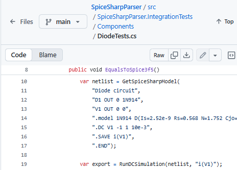

1. SpiceSharpParser.IntegrationTests

Hi Viacheslav. Thanks, the link you provide shows how to simulate components, for example, a diode:
One more question: An option to have outputs with units? I think it would just be a matter of identifying time, volts, and amperes. It would be very practical to be able to use milli, micro, and nano prefixes.
