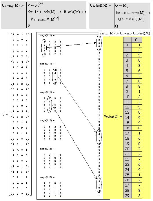

Matlab => MDA [Muliti Dimensional Array]
Mathematica => Cell Array
They just have their system. I can do whatever from this example
and very quick too, just few more modules.
