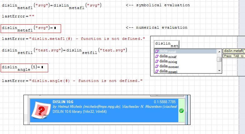

Thank you Viacheslav, disabling the recalculation I can save your example and I experienced some small improvements (still doesn't works):
Files (worksheet, log, output svg): DISLIN.zip (19.63 KiB)已下载 618 次。
"Functions not defined":
![2016-02-14 18_44_49-SMath Studio Desktop - [Page2_].png](/zh-Hans-CN/files/Download/Dvao5P/2016-02-14-18_44_49-SMath-Studio-Desktop---[Page2_].png)
Aside note, crash occours if the output directory doesn't exists;

I forgot to say that you should not save the file! Look at the contents. Function names lost prefix. Therefore it is necessary to follow exactly what I write.
1. Restart SMath Studio.
2. Turn off autocalc.
3. Do not save the worksheet!
4. Enter functions line by line, don't forget to add = (do not press F9!).
5. Now you can press F9.
EDIT: The library interface is ugly. You must read the user manual before continuing experiments. The order of calling functions is important.

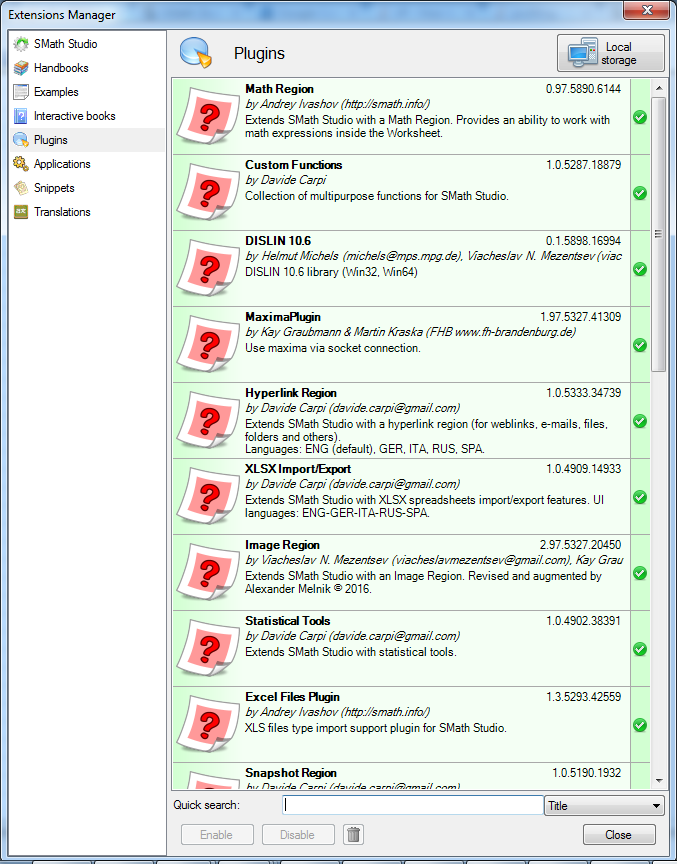

Davide Carpi 2016/2/25 07:14:00
DISLIN 0.1.5898.14938 ?
This is because of other program settings. I'll fix it now.

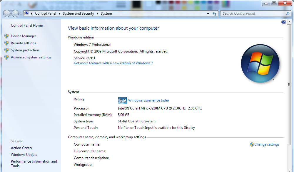

Strange on my system Smath crashes and I am forced to close the program.
The release installed is
Working under Windows 7 Professional
Franco
Franco
You mean to uninstall all Smath even if I am using actually an updated version of Smath portable.
Franco
Franco
I have Windows 7 Ultimate x64 and it works fine for me. Show me log.txt (in plugin folder). Maybe environment variable TEMP points to a long path and DISLIN can't get access to the temporary folder. My TEMP=C:\Temp
This is just a guess.
