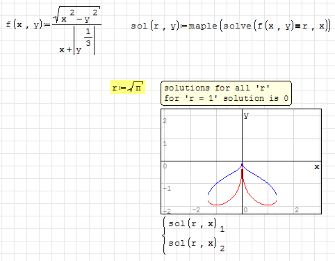

The limit of a function of two variables is the contour limit @ user value.
Maxima X_Y plots by default the 0 level contour. For other 'level(s)'
use the maple solve block.
What is a Maxima X_Y plot? Why would you need some solver for other levels if you can plot 0 level?
As I understand, the bivariate limit is a function of the x,y values and of the direction of approach.
It would be helpful to see what you expect to see (examples).
What is the meaning of: handle limits of functions of 2 variables
Wait for the f(x,y):=
X_Y plots contour of any level in the domain of existence w/o solver.
The solver is for discretising the export.

Wolfram is of no help as you can check by yourself: it is ill posed.
"the limit of functions of two variables ..."
read: implict f(x,y) have solutions wrt 'x' or 'y' alternately.

Wrotethis is just to know if it is possible from Smath using Maxima to handle limits of functions of 2 variables.
From the previous work sheets, answer is probably "NO"
Maxima will plot many implicit functions.
