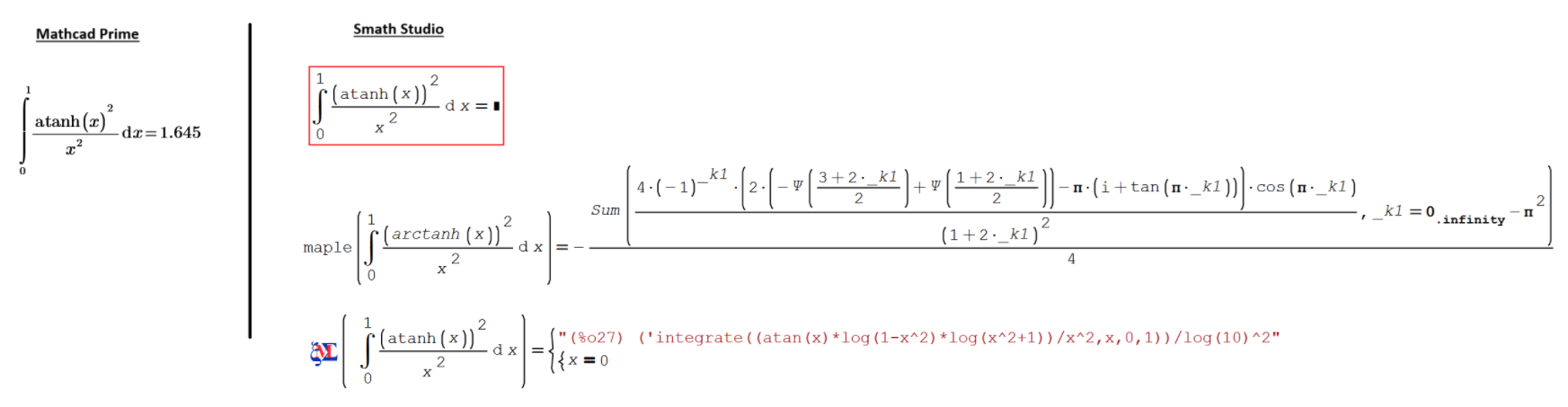

Another integral which Smath cannot solve while Mathcad Prime can:

Maple provides the exact solution as an infinity sumatorie. Whether that expression is useful or too unwieldy is another question.

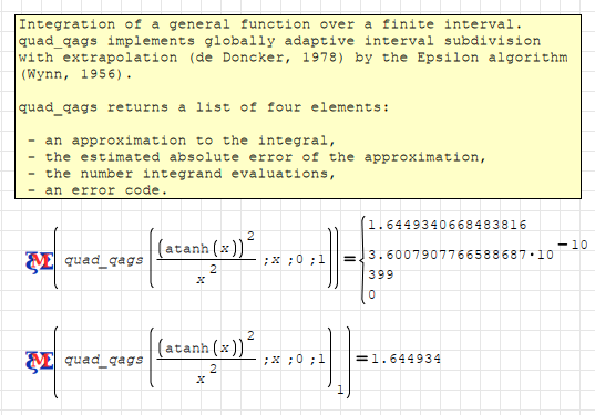

This will be a very late reply, you can even call it necroposting.
But I think it will be useful for some maxima users.
For finite integrals wouldn't be solved easily, use quadpack.
https://maxima.sourceforge.io/docs/manual/Integration.html#Integration
