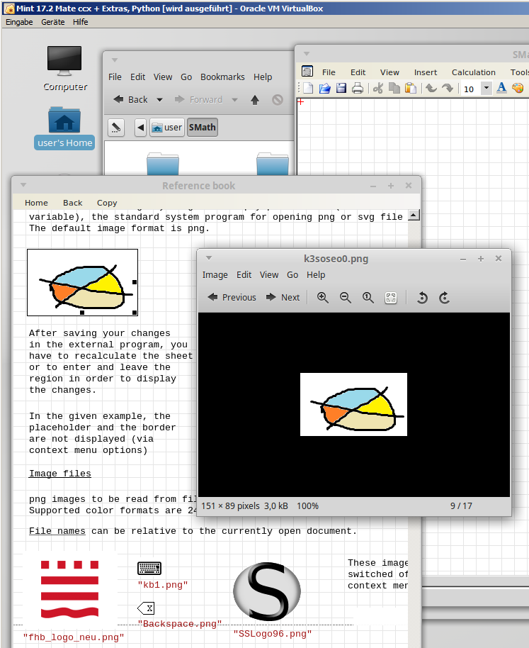

You can use the image region (Insert> Image).
You can place a text string in the placeholder, this is interpreted as filename (png or svg). Use CurrentDirectory(DocumentDirectory(""))=1
if you want to use relative file names for portability.
You can place a matrix in the placeholder, this is interpreted as grey values.
You can double click the region to launch your system application for opening png files with a new empty temporary file. Do your artwork and save the file when quitting the application. You can later revisit the file for editing, and you can zoom the region in a nondestructive way. You might need to recalculate the sheet to make changes visible (also when opening a document with such images, you might need to press F9 before they actually appear)
The images are embedded in the .sm file, thus the .sm documents are portable. This also works under Linux (tested with Ubuntu/Mint).
The context menu offers the choice to hide the placeholder, to remove the boundary or to reset the image to original size.
The maxima Draw2D() and Draw3D() functions create temporary png files and return these file names, thus you can put such Draw expressions directly into the placeholder.Plugin Image Region.sm (81.1 KiB) downloaded 1030 time(s)..
