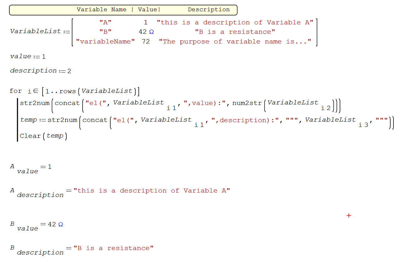

A matrix approach:
AssignValueAndDescription.sm (7.5 KiB) downloaded 992 time(s).
Arie 2022/10/26 09:59:00, Alvaro 2022/10/26 14:26:00

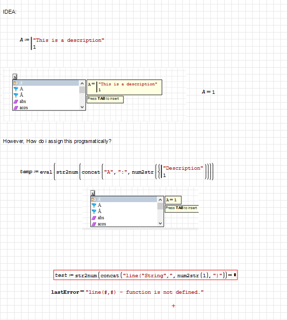

I had another idea using line function. But i'm not sure how to do it programatically... Any Ideas? Is it even possible?
Worksheet8_alternateIdea.sm (22.9 KiB) downloaded 1037 time(s).
⚜ Kenny Lemens, P.E. ᵂᴵ 2022/10/26 10:57:00

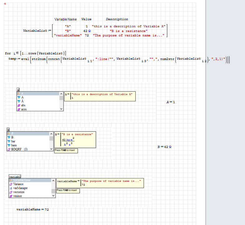

Aha! I figured it out
I'm pretty happy with this solution.
Here's my updated file for a reference:
⚜ Kenny Lemens, P.E. ᵂᴵ 2022/10/26 11:32:00, Alvaro 2022/10/26 14:29:00
