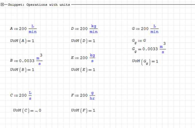

Hello
The unit operation snippet fails to detect units.
Snippet_Units_Fail.sm (33.04 KiB)已下载 1671 次。

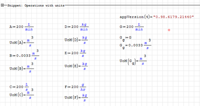

Try this
Snippet_Units_Fail.sm (32.38 KiB)已下载 1594 次。

Hello David
引用
Try this
Thank you very much for your answer, but the snippet fails, since instead
of finding the units, it only obtains the value of 1

I see the issue. The function look for a numerator/denominator pattern in the num2str() text, but doesn't handle cases in which multiple divisions are involved.

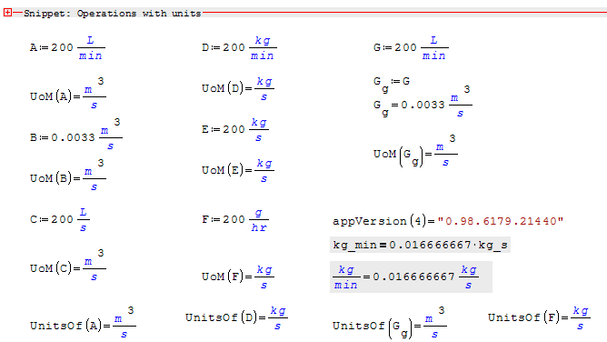

Hello David
Thank you very much for your attention, I hope the Snippet has a fix-
On the other hand, I ran the snippet in version 6179,
and it works perfectly. How is that possible?

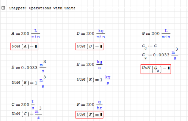

I'm not sure, however if you need a urgent fix here you have an easy way to make it working the same way.
