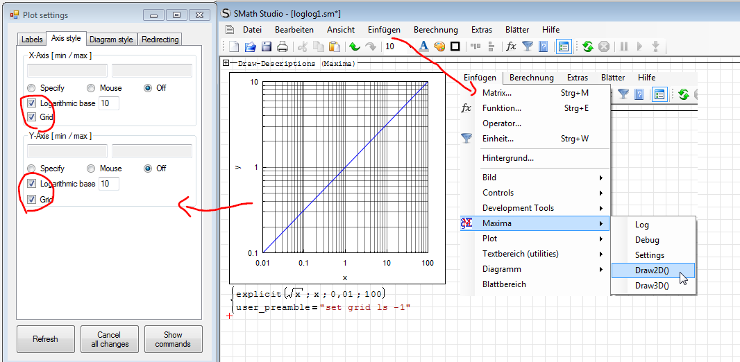

![2017-11-06 09_14_32-SMath Studio - [loglog1.sm_].png](/zh-Hans-CN/files/Download/Uyn4FD/2017-11-06-09_14_32-SMath-Studio---[loglog1.sm_].png)
loglog1.sm (246.92 KiB) downloaded 1033 time(s).
WroteI want to plot log-log graphs.
So, the log-log plugin is not delivered with the latest stable version.
The logpts base/user is something most useful to populate the low region
of Engineering plot as well as pure maths.
Read 1rst "Demo", 2nd "Application"
Cheers, Jean
Utilities logpts Demo.sm (16.41 KiB) downloaded 1025 time(s).
Utilities logpts Application.sm (28.29 KiB) downloaded 983 time(s).

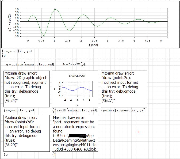

Here is the error message that I am having trouble with, hopefully attached this time. I now realise that adding an attachment is a two step process (upload AND attach) opposed to a one step upload!
With regard to the Maxima installation on my laptop, it is located in the C:\ directory, SMath is in C:\Programs (x86)\, and the Maxima path has been added to the Maxima settings in SMath. The version of Smath I have is 0.98 (build 6484).
Strange. What Maxima version do you have? Could you please run the attached test file?

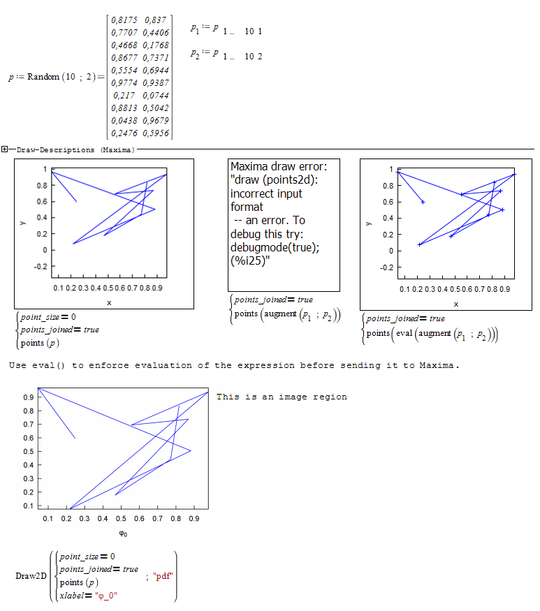

I am trying to plot XY-scatter points that are saved in matrix-form. I can do this in the native SMath plot feature and the XY-Plot plugin, but can't seem to recreate this in the Maxima plugin...I get drawing errors.
I tried dowloading an running the "Plugin%20Maxima%20Test.sm", but it was calculating for over 10 minutes and seemed to have some calculation failures in it. I am using SMath version 0.98 (build: 6484).
Can anyone see something that I am doing wrong? (PDF and JPG attached)
Thanks!
Plugin-Maxima-Test.pdf (1.01 MiB) downloaded 672 time(s).
points.sm (175.46 KiB) downloaded 989 time(s).
points.pdf (204.64 KiB) downloaded 570 time(s).

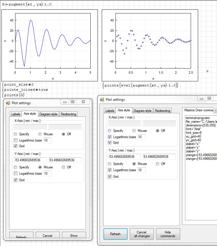

However, the "Logarithmic" scale feature doesn't seem to be working.
With the "Logarithmic" box checked off, any changes made to the points equation (applying a 0.5 factor, for example) won't even be shown on the graph.

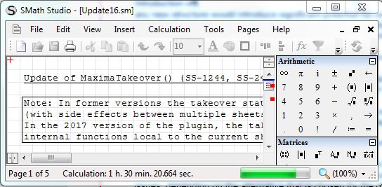

And I'm not sure if the logarithmic issue that I am having is related, but when I opened the "Update16.sm" file, it was still calculating after 90 minutes (stuck in a loop somewhere). This was the same sort of behavior that I was seeing with the previously noted test file.
WroteThe plotting function is not robust enough to silently suppress undefined values.
In log-plots make sure that your points are strictly positive.
Mathcad 11 would not log-plot data starting with variates '0'
