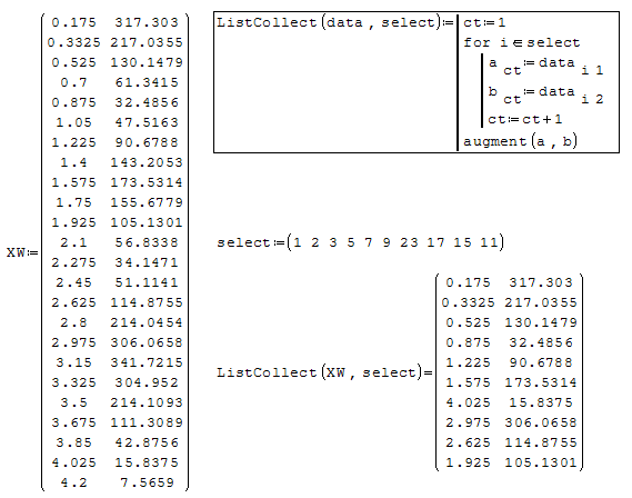

#4 已发布: 2016/3/28 17:42:27
983个赞,共6,866个帖子。
The data table can be any size, search any rows/any col.
Just modify/adapt to your project.
