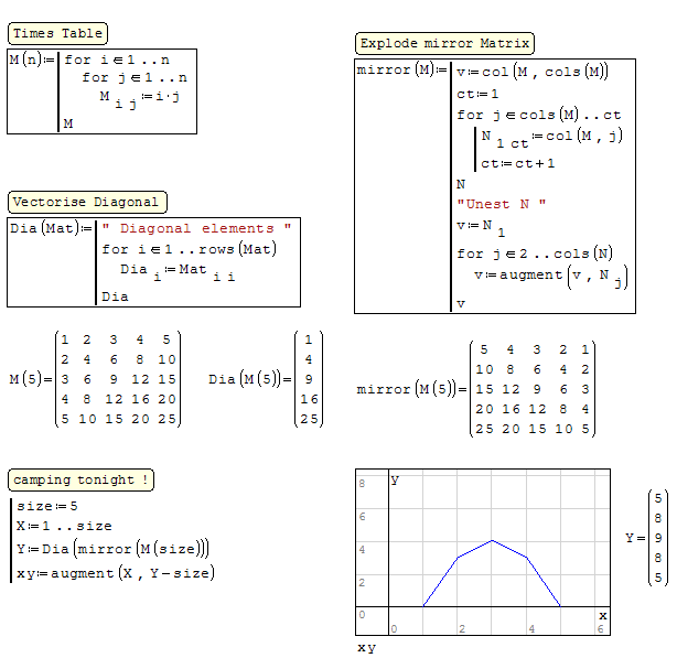

How could I get a vector from a diagonal?

Sorry , what do you mean ?

Something like this? diag2vec()

The question is if there is an easy/direct way to do it.
Yes, this can help.
Like this ?
Like this ?
Utilities Matrix [Times, Dia, Mirror,Euclid].sm (39.12 KiB)已下载 1187 次。
Thank you.
