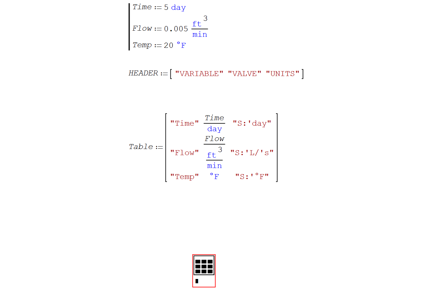

I just inserted a table region into my sheet, but I can't figure out how to change the number of rows or columns, or how to type in it. I select the boxes and a popup that I don't know what to do with pops up.

I typed exactly what is in the Table Region Carlos.sm and then added the table below with the Insert Table command, and still it does not work.

Once you have inserted the Table from the insert menu,
in that 3 x 3 chess board: type Table in the place holder.
Print Screen, paste in Paint, Select, paste in a tool
that will save as *.PNG [I use WinGrab for over 20 years]

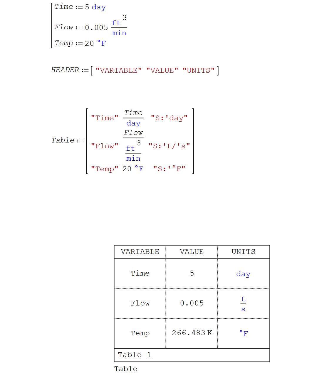

I defined the temp in degrees F, but it put it in degrees K

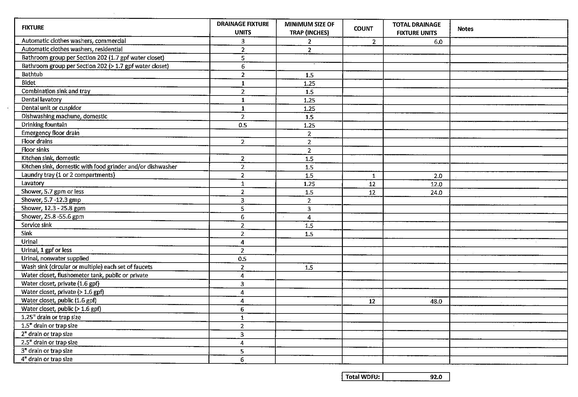

What I want to do is produce a table similar to the image I attached: DFU TABLE.png Also, What does the first definition do for the table? In the example it says
Time:= 5 day
Flow := 0.005 ft3/min
Temp := 20F
Smath is an advanced CAS. Maybe purchase a tool to list the barn population.

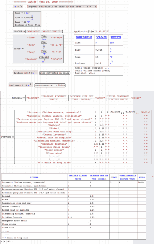

Hello
This is a part of your table
Table Region Carlos_R1.sm (28.69 KiB)已下载 1233 次。

After you produce the table in SMath, are the numbers in the table usable in a calculation? If not, then there is no point, and it is better to just copy and paste from Excel.
Of course, look at the operation fixture 1.2 by fixture 1.4, which results in 4. within the same table.

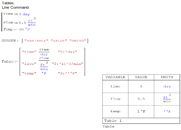

Why does my table say 1 deg F and not 30 ?
Please: attach the document so helpers won't have to redo.

Seems to me that simply you are not using the Temp variable in your Table matrix.
then, it goes completely crazy and puts in an arbitrary value of 137.79

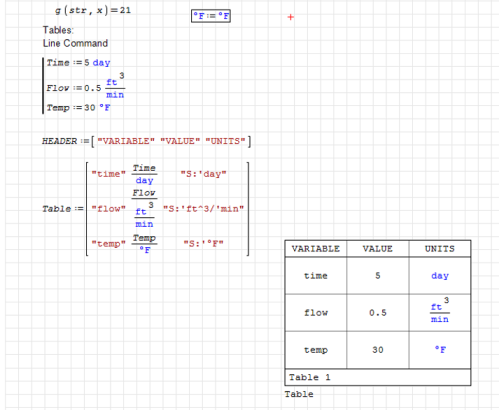

Here is the correction. It was still necessary to define your own unit of
degrees farenheit to prevent Smath Studio from interpreting it as Kelvin degrees.
On the other hand in the table was missing include the variable Temperature
(temp) divided by the units (° F)
test _Britt1.sm (19.93 KiB)已下载 1236 次。
