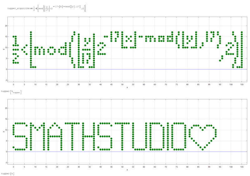

SMath论坛 SMath Studio Samples Tupper's self-referential Formula 1页(1条) Tupper's self-referential Formula - A formula to visually represent itself, and everything - 消息 转到最后一个帖子 #1 已发布: 2021/1/13 22:51:57 overlord 600个赞,共1,381个帖子。 组: Moderator You will obviously need big integer arithmetics extension.tupper.sm (204.5 KiB)已下载 1380 次。tupper.sm (202.26 KiB)已下载 1394 次。 (revised)You will need Big Integer Arithmetics plugin.You can install it from SMath>Tools>Plugins.Wikipedia page for information about formula:https://en.wikipedia.org/wiki/Tupper%27s_self-referential_formulaYou can create your own tupper number with this site:https://tuppers-formula.ovh/ 3位用户喜欢此帖子Вячеслав Мезенцев 2021/1/14 03:40:00, Davide Carpi 2021/1/14 04:10:00, Alvaro 2021/1/14 15:59:00 1页(1条) 有新帖 无新帖
