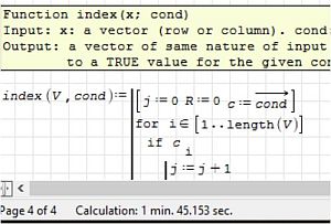

#30 已发布: 2018/2/16 15:49:26
2,344个赞,共4,057个帖子。
组: Super Administrator
BTW, I would suggest to use another version of plotG which is much faster then previous one (and simplier):
plotG(x,y,char,size,color):line(k:range(1,rows(x)),augment(x,y,el(r3,k):char,el(r4,k):size,el(r5,k):color),2,1)
plotG(xy,char,size,color):line(k:range(1,rows(xy)),augment(xy,el(r3,k):char,el(r4,k):size,el(r5,k):color),2,1)

Hi. Just one more thing, I guess: the only one remaining matlab function, mwfind replaced. (Orignal work have many) If I'm not wrong, it is now 100% SMath native. But double the amazing time obtained by Davide. But it's just a "scalar" implementation, sure there are better ones.
PD: I don't replace plotG because don't understand very well that syntax.
InterX.r1 - ranged indices.sm (90.75 KiB)已下载 1211 次。
Here's my pure SMATH find function. with similar time to MWFIND.
InterX.r1 - ranged indices_alyles.sm (94.58 KiB)已下载 1245 次。

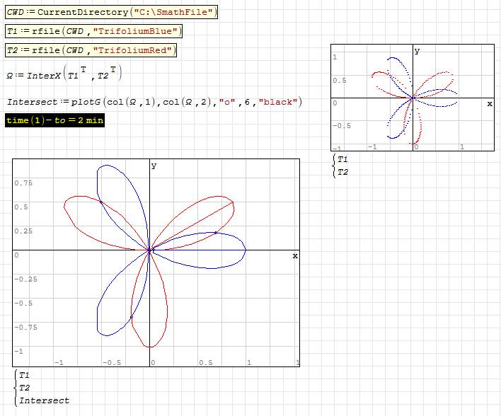

Hello Marco,
I'm trying for the intersection of the two Trifolium, .
blue => native ... red => rotated.
They are created in "Page1 Trifolium.sm
Then recalled for the InterX(T1,T2)
Nothing happens >>> 1 hr ? [Win 7 Starter Edition ... 1.66 GHz]
Is it supposed to work ? Thanks in advance.
Page1 Trifolium.sm (32.5 KiB)已下载 1495 次。
Maths InterseX [Marco].sm (51.7 KiB)已下载 1019 次。
#40 已发布: 2018/2/19 00:26:16
1,139个赞,共1,805个帖子。
Hi Jean.
You are using an old version of the program. Try this one.
Notice that the point (0,0) is found several times by the algorithm. It could be interesting to check if it get the correct number of crosses at the origin.
InterX.r1 - ranged indices_alyles.sm (88.24 KiB)已下载 1203 次。
