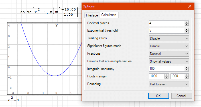

#2 Posted: 2018/10/16 06:38:47
126 likes in 341 posts.
The solution method is numeric and depends on the search limits of the roots. By appropriately setting the limits to the nearest values (Tools->Options->Calculation->Roots (range)-10 + 10), you get the correct result. Downstream of a numerical solution, it is always necessary to proceed to the direct verification of the result (sanity check).

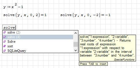

#4 Posted: 2018/10/16 06:57:11
1,441 likes in 2,932 posts.
How to handle with it if it is defined globally for spreadsheet and not for exact calculation?
Use solve(4) instead of solve(2). The one with 2 arguments it's handly for calculations on the fly, but not reliable for structured calculations.

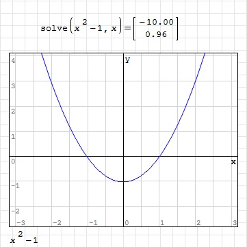

#5 Posted: 2018/10/16 07:08:50
1,106 likes in 1,784 posts.
Full reinstallation (including deletion of plugins) repaired this problem. But what was exact source?.. I don't know.
If you put some big range, you get wrong answers, like in this picture
But now, there is a question: how to use this range? (cuz I remember that I had to increase it becouse there were no roots in my previous calculations and now I need to decrease it).
You can't. Solve with default range for search "all" the roots it's just a helper for some easy calculations. If it give the correct answer, good, but if not, there are not to much to do.
For that you must to use the solve with 4 arguments (or other numerical solver), and get the roots one by one.
