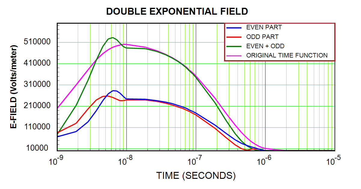

Being a brute force type of programmer, in the meantime, I decided to try something. I created a second calculation at negative times using the range variable as before. Now, I have a positive time and a negative time result from which to calculate the even and odd parts. The results are shown in the attached PDF for 30 time points per decade and 100 frequency points per decade. These definitions are in the blue area for time and orange area for frequency.

With the increased time and frequency points per decade, it runs for almost 4.5 minutes. The transform is very good. If I keep the original time and frequency points per decade = 10 as in my original submittal, it runs for 7.6 seconds; however, the transform is not very good as shown in this figure.
