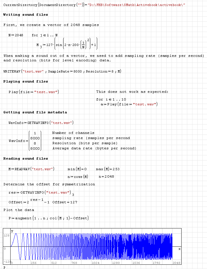

If there a way to write a file that plays music?
Give frequency, duration, etc.

Yes, see attached file.

This does not work as expected
MathcadFileAccess plugin updated. Try now.
