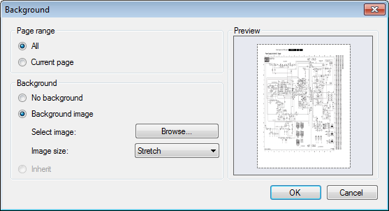

is it possible to create typical page layout? For example with my own header, page number etc?
BR.
edit: I saw that there is an option "page layout", where you can steer main parameters by text, however I would like to add some small logo. Is it possible, too?

Hello [userlink]mdominiak[/userlink],
As for now the only way to setup such things is to use a background (Inset > Background > Background image)

Davide, thank you for your reply.
As I understand there is no possibility to add it automatically on each page, therefore I will have to add it manually each time?

The background image (f.e. containing the logo or the title block) can be extended to any page, dynamic items such as the page number are accessible only in the header/footer.

The question from post 3 is afaict about the background being applied to newly created SMath documents
Ah! Good point. As for now these settings are not stored, therefore you have only 2 ways:
  1. Save a template (a blank document with your favorite setup) and use this file when you start a new project (open it, save as new filename, start coding)
  2. Setup from scratch everytime
