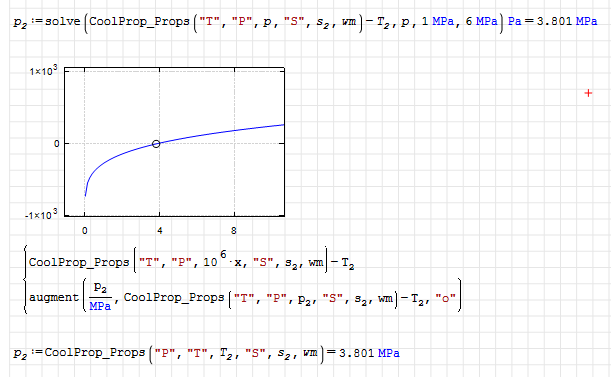

Take care :
Your CoolProp function, as you write it, does not change the sign, between the two limits of the variable p :

Hi. The guess values, in this case the range, are part of the solution, this means that you must know where the numerical procedure works fine. In this case the interval 1 MPa ... 6 MPa.
3-2-CoolProp-Solve.sm (49.75 KiB)已下载 1623 次。

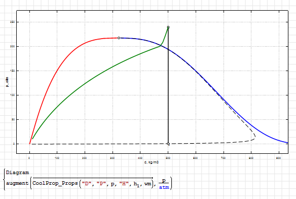

It works! By p.0=240 atm
Fireless-Locomotive.sm (882.15 KiB)已下载 1715 次。
But by p.0=140 atm ---???
