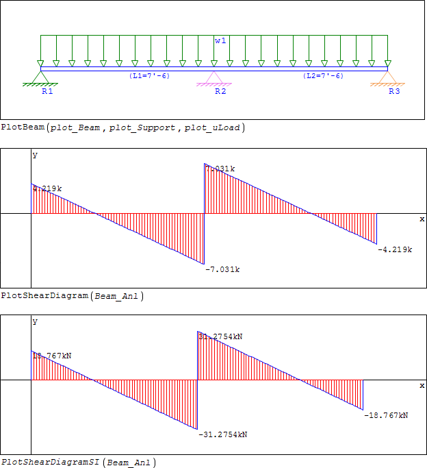

Hi All,
Although I have been using SMath for a good 6 years, this will be my first question on the forum.
I would like to know, while using the FEA BEAM ANALYSIS PLUGIN, how can I edit the units displayed on the 2D plot? It is by default in Imperial units and I would like it displayed in Metric Units.
Thanks :d

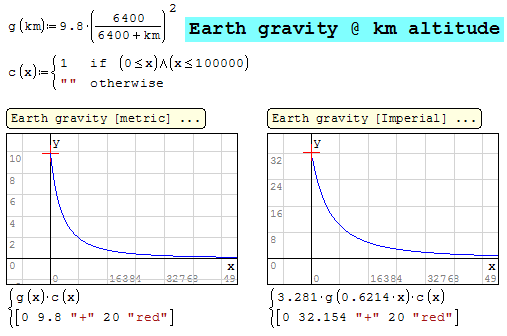

WroteIt is by default in Imperial units and I would like it displayed in Metric Units.
1. Disretize your Imperial,
2. Convert the X's in metric,
3. Convert the Y's in metric,
4. Re-tabulate/augment/plot
... you can convert both directions globally
Cheers

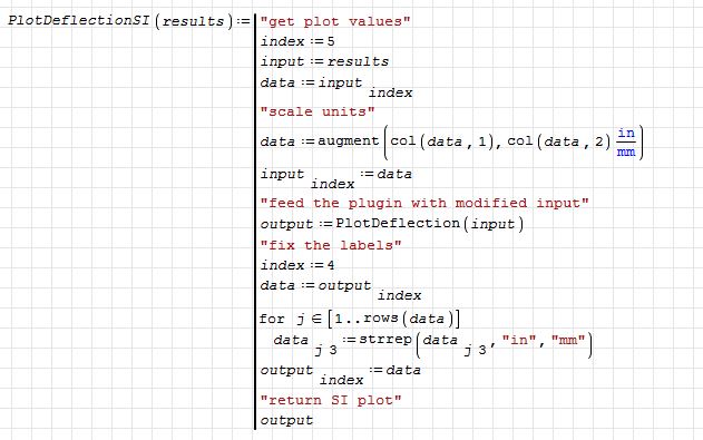

I don't see any public code for that plugin, so there isn't much to do on that side. However if really needed you might write some sort of "wrap function" to post-process the results and convert them to SI units.
Hi Davide,
Thanks for letting me know.
Any thoughts on where should I start with that "wrap function?
Have a good weekend.
Thanks,
Thanks,
Either
or
PlotShearDiagramSI.sm (5.03 KiB) downloaded 1031 time(s).
![2019-07-19 12_23_05-SMath Studio - [Beam Analysis Sample-1.sm_].png](/zh-Hans-CN/files/Download/mCabpN/2019-07-19-12_23_05-SMath-Studio---[Beam-Analysis-Sample-1.sm_].png)
- Scale the input values
- Process FEA results using the plugin
- Fix the labels
or
- Scale the output values
- Fix the labels
