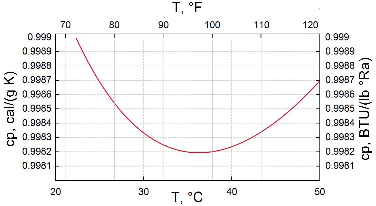

#1 Posted: 2024/5/25 12:58:28
Valery Ochkov
Valery Ochkov
66 likes in 682 posts.
It will be good to have in SMath
2X-2Y.sm (12.9 KiB) downloaded 1455 time(s).

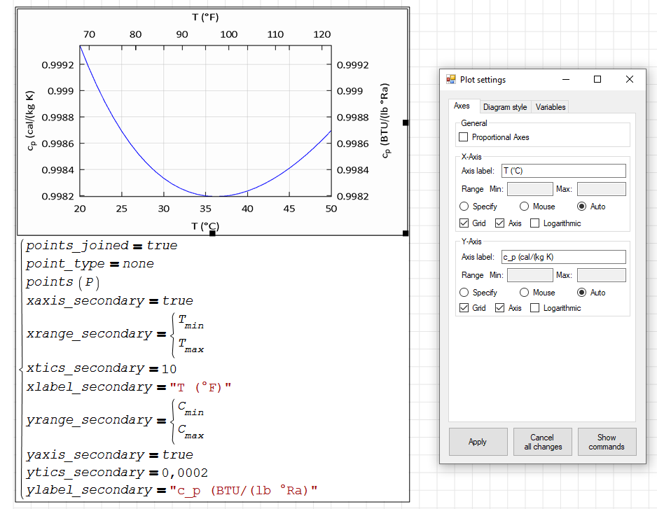

#2 Posted: 2024/5/25 16:02:10
1,353 likes in 2,264 posts.
If you let in Maxima, then you can have it.
2X-2Y_Kr.sm (169.77 KiB) downloaded 1385 time(s).
