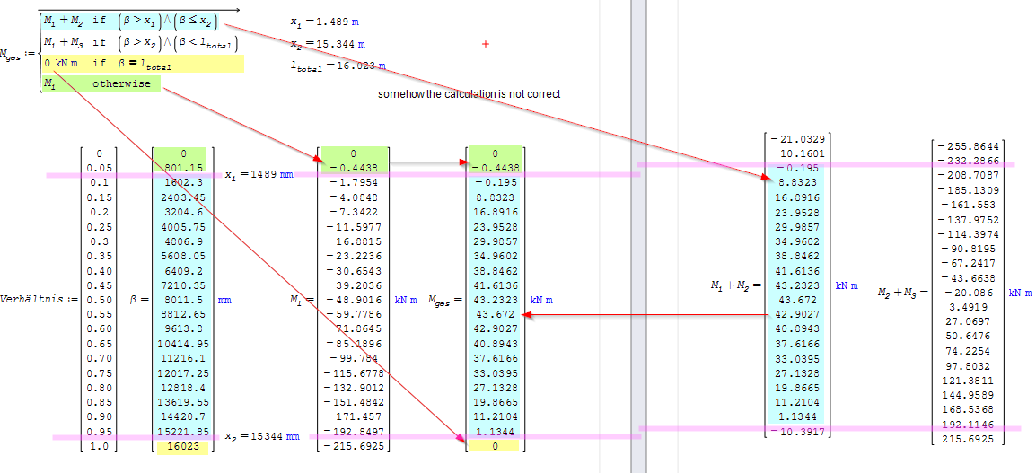

Hallo guys,
i prepared my calculation but i i am not sure if i can define my bending moment in such a way
Special look on the field moment i made
M1+M2 for
M1+M3 for
0 if....
M1 otherwise
is this correct?
thank you br Stefan
Test.sm (75.28 KiB)已下载 1277 次。

i do consider some problems i think this math code is not correct

I'm not sure what do you expect, but the values are assigned according to your logic
2021-09-02 17_25_51-2021-09-02 17_22_22-2021-09-02 17_04_09-SMath Studio - [Test.sm_].png - Visualiz.png

ok thank you it seems to be correct !
best regards, Stefan
