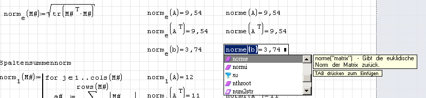

#4 Posted: 2013/5/17 09:29:55
1,353 likes in 2,264 posts.
enorm() seems to work now (with 0.96.4884). The workaround from the customFunctions plugin is switched off here, as the dynamic assistant (invoked by F12) shows.
#5 Posted: 2013/5/17 10:03:03
1,441 likes in 2,932 posts.
Good, I'll disable the customFunctions workaround
