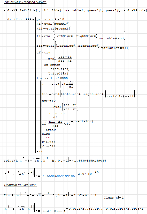

I figured I am not the only one who can benefit from a simple numeric solver that "just works".
It will likely become obsolete once Davide updates the Nonlinear Solvers plugin.
Enjoy.
SolveNewtonRaphson.sm (12.99 KiB)已下载 1438 次。

If only either of the two could handle the units I would not need to go through all the trouble. They do not, hence I had to get inventive.
