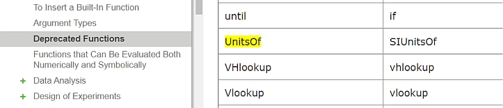

Hi. I think that SMath's UnitsOf() it's well defined, not like the equivalent in Mathcad, which it's deprecated
and substitute by SIUnitsOf(), even the Mathcad error was related with the default unit system setup (SI=MKS, FPS or CGS): https://support.ptc.com/help/mathcad/en/index.html#page/PTC_Mathcad_Help/example_explaining_SIUnitsOf.html

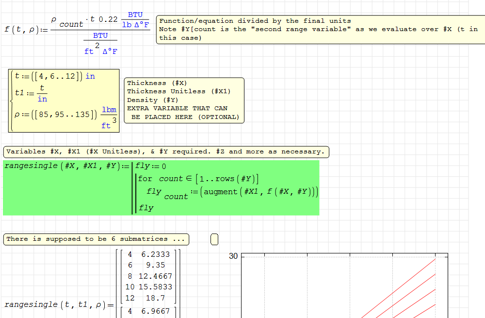

This is basic. I need to eliminate units based on itself. This is so I can use it on multiple equations with varying units within my functions

I need the units for the formulas and as a double check. At the moment, I just created/defined a second variable (t1:=t/in in this case) to make it work.

Using UnitOf() as a variable, does not work. It divides out and changes the value as shown in the first post. I'm trying to eliminate having to define t1 (in this example) Heat Capacity Function1.sm (20.42 KiB) downloaded 1342 time(s).

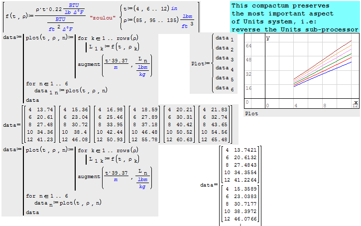

The unit system is an SI sub-processor.
Once it has converted in 'm' you can get a vector absent of viewing units.
At this point, if you want your original vector in you must
reverse Engineer the SI sub-processor.
Unit Waterloo.sm (20.28 KiB) downloaded 1260 time(s).
Your example is more detailed than mine, showing the same thing. In your case, you multiplied t by 39.37 for the conversion to inches. My intent was to "normalize" and just use the root variable to eliminate the units.
This appears to not be possible and I will just continue to define var1:=#var/units. The function is working on multiple equations, this would have been the "cherry on top".

I you have to invent a particular reverse-Engineer for an odd application,
may as well not use units, that will solve all cases.
Or, more wisely convert before hand to SI, unfortunately here,
°F, °K don't exist ... what !
No, they don't exist ... latest ITS-90 have normalized only few fixed points.
Not in °F, °K ... in °C.

This is the one you could not open, so I'm posting the revised function below. In this example (you have your sheet to look at), I just want to eliminate the variable #X1 as all it is is the variable #X unitless. As mentioned above, I just "defined" #X1 as #X/units and we are fine. I am updating calculations to use this "generic" function for consistency. I was just hoping to eliminate having to define #X1 as a separate variable ...
