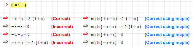

Why does SMath's algebraic engine give wrong results in basic algebraic operations?
How to solve it without using extensions such as Maple?

SMath doesn't seem to like starting with a unary minus. Try:
