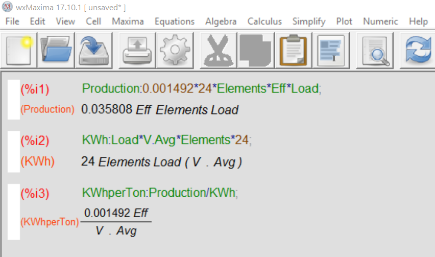

How can I achieve this in SMath (currently wxMaxima)

I wish to ...but this feature is disabled for me ..that's why the image

You might try something like this

Ah... Ok thank you. You have made them units
