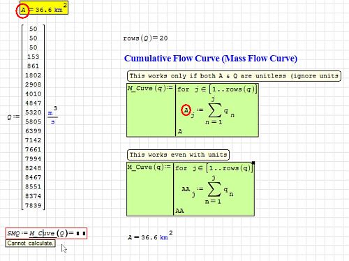

I get an error when using the same variable name in worksheet and inside the program loop.
Why do I get this?
In many earlier SS versions (can't remember versions) it worked perfect
Assignment Error with Units in Program Loop.sm (7.64 KiB)已下载 1244 次。

look here

Thanks Davide. I got it.

... added the note wrt scalar Σ
Assignment Error with Units in Program Loop[1].sm (15.84 KiB)已下载 1024 次。

Thanks Jean for the useful tips.
