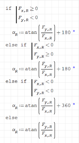

If I'm confused and the angle of the vector with components (4,2) is not 26.5651°, could you explain to me what is the correct value, please?
The correct value is Smath code for Smath projects.
Take care Alvaro ... Jean.
Great!. I hope that this also includes no useless code or mismanagement of units, accurate capturing scientific concepts and the correct handling and debugging of errors in the code, using the latest available version of SMath to thus collaborate with its development and improvement without representing a burden that constantly reintroduces the same errors by using absolutely outdated versions with more than 5 years of obsolescence and practices already discredited long time ago.

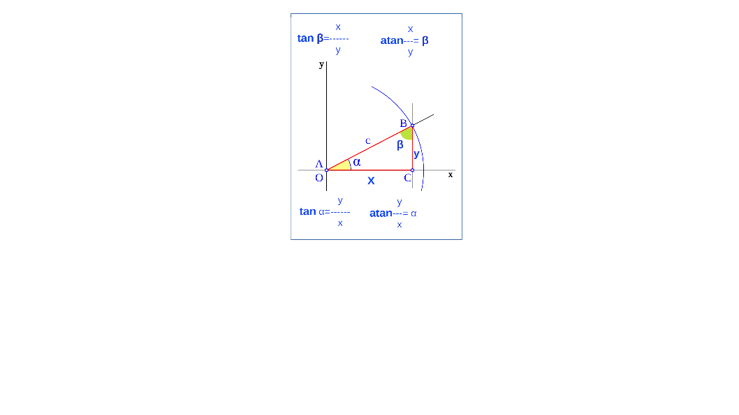

As indicated in the published, it is requesting the calculation of "aº = atan(x/y)",
which corresponds to the calculation of the angle next to the Opposite Leg

From the first post:
From the big picture in the post #6:
And form the physical context, where is trying to decompose a plane Force into its horizontal and vertical components, it's obvious that those are the correct formulas, and not the ones "handwrites" in the post #3. For this is because one choose a wysiwyg live math editor like SMath and not a death plane text like octave for make engineering calculations.
which corresponds t▪o the calculation of the angle next to the Opposite Leg
That ends this atan(▪,▪) pugila

Perfect. As my last post in this topic, I can conclude that this angle is atan(4,2) = 63.4349° in your world, but it is atan(2,4) = 26.5651° in mine; that the formulas that are written in SMath are irrelevant, as are any evidence that that angle is not the one you say. Where was that "The correct value is Smath code for Smath projects."? Forget it, I really don't care. I just wanted to prevent you from being able to fool others, but I admit that you are very good at it. You win.
#27 Posted: 2023/6/15 17:17:56
Your conclusion is correct.
The demand was atan(x/y)
Your interpretation is atan(y/x) ... End of it.

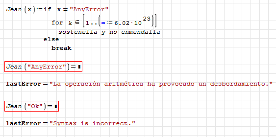

While walking in the forest,
if you come across twice the same tree, you are lost !
