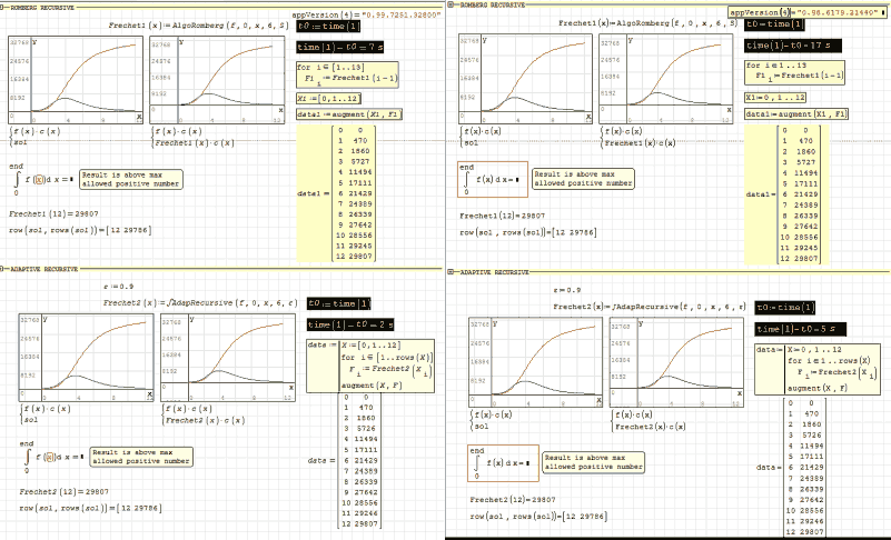

Hello Jean
Apply the recursive Romberg method and the recursive adaptive method to your function.
Integrate Frechet_Jean_CBG_SS6179.sm (52.54 KiB)已下载 1402 次。
Integrate Frechet_Jean_CBG_SS7251.sm (55.26 KiB)已下载 1372 次。
WroteHello Jean
Thanks Carlos, saved for reference
