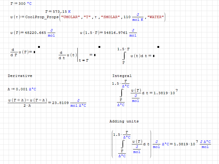

Hi. How can take the derivative or integral of a function involving coolprops?
Thanks in advance.
#2 Posted: 2018/1/28 06:41:06
Hello Alvaro,
I have the impression that numerical derivative and integration issues (especially with units) will be here on the Forum for ever . I wish I was wrong.
The analytical attempts with Maple or Maxima will fail here. We are forced to use numerical solvers or functions here. Here is the solution (not straight forward though) only in SMath.
I tried Gradient.CD() from NumericalSolvers plugin, but I failed.
Alvaro 2018/1/29 10:30:00

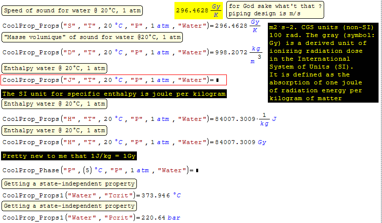

No comment ... just learn that fluid speed in piping
is no more m/s since century, rather Gy/K ... does is
run faster/slower/fly out of pipe/spits out $$$

#10 Posted: 2018/1/29 16:07:28
These two turned red in 6179, quite puzzling.
Are they red in your 6484 ? if YES => Oh !
