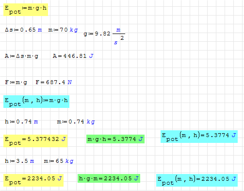

Hi jenspraest,
It's not a bug, just a behavior...
Please hold the mouse on the [MATH lang=eng]E.pot[/MATH] definition... you can see that SMath assign all available variables, so when you make a call to [MATH lang=eng]E.pot[/MATH] only the [MATH]h[/MATH] value will be replaced; to have the "right" behavior you need to place the definition before the variable assignments or to create a function [MATH lang=eng]E.pot(m,h)[/MATH]
regards,
w3b5urf3r
