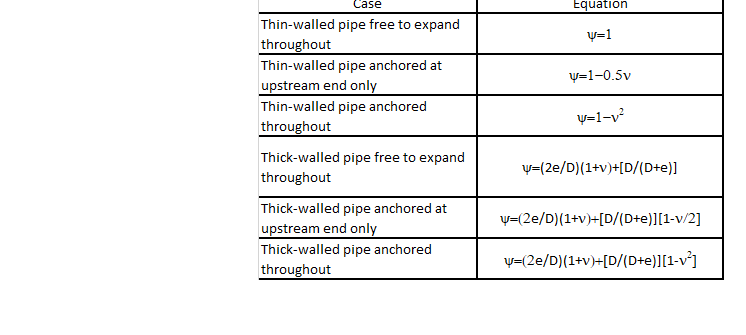

Can text be included in an if statement? For example:
If "Thin-walled pipe anchored throughout" then P=1-v.
I have various conditions that different formulas would be used depending on the conditions, see below.restraints.png
