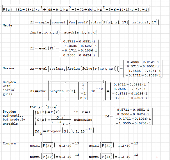

Hello, I want to solve a quartic polynomial with complex coefficients.. I tried "polyroots" function but it gives an error "cannot calculate",, Is there a plugin or a function that can solve a polynomial with complex coefficients in SMath? Thanks in advance

Here an example solved by using Maxima plugin:
best,
Oscar
best,
Oscar
How to put these answers of Maxima plugin inside a vector?

#5 Posted: 2023/11/18 20:18:30
597 likes in 1,377 posts.
You can use maple() too.
Maple has a fsolve() function.
Which uses floating-point arithmetic.
A little trikiest

Okayy,,,The trick using num2str is so cool..
And thanks overlord, I didnt know about this maple one

Hi. Another way.
zroots.sm (19.36 KiB) downloaded 1154 time(s).
