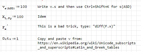

I generally like SMath better than Mathcad (especially since they went to the "Prime" version), and I've even found some things that SMath will do that Mathcad Prime won't. but in trying to replicate formulas from the American National Design Standard (NDS) for wood design, I am running into more and more examples of variable names and subscript characters used in the NDS publications that aren't allowed in SMath. The biggest advantage that Mathcad seems to have over SMath at this point is in formatting (their fonts in math regions seem more legible) and in allowing more variability in variable declarations (e.g. characters not allowed in SMath, or characters combined in ways not allowed in SMath). Are there any options for workarounds in SMath that I'm not aware of? I'm teaming up with another author to write a design guide for wood design, so the formatting is more critical in this published work than it would be for my normal calcs at the office. If it were just my own calcs, I'd just use alternate notation, but I'd like to match up as closely to the national standard's notation as possible when publishing a book related to it.
Below is an example of a variable used in wood shear wall calcs where 2 values for shear modulus (Gv) and thickness (tv) have been combined into 1 tabulated value of Gvtv with the "v" in subscript. SMath doesn't allow getting in and out of subscript entry in one variable definition, as far as I know.
The vs.asd entry below that is one that neither SMath or Mathcad will accept as NDS shows it, since NDS uses "s(ASD)" in the subscript, and neither program recognizes parentheses as part of a variable name, even in a subscript. So for that one, I may just have to use a period or underscore or some other alternate notation from what the published standard uses. Another case that I see used a lot in published engineering calcs is the use of a comma in a subscript, such as "P1,y" where the 1,y" would be in subscript. I don't think either Mathcad or SMath allow that, but it is a common notation from what I've seen.

The Fc⟂ entry is one I figured out I can insert from Windows Character Map, although it comes out somewhat tilted in SMath, like it's italicized.

Finally, the last picture is from Mathcad of how NDS represents the adjusted design value for allowable compressive stress perpendicular to the grain. They put the apostrophe after the subscript. But similar to the Gvtv variable, I can't leave subscript entry to put the apostrophe at the normal text level in SMath. I can put it in at that level before the subscript, but then it doesn't quite look the same. Has anyone else used SMath for published works where you wanted to match a particular formatting like this? Is there a workaround?

Hi Jason. Some notes.
SomeFormats.sm (3.89 KiB)已下载 1269 次。
2位用户喜欢此帖子
Jason McCool 2021/8/1 19:16:00, Erick Valentino 2021/10/1 19:27:00

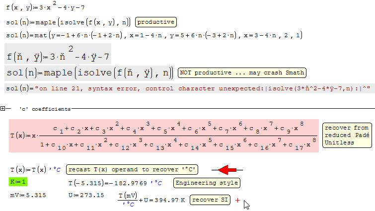

Smath supports decorations ... no maths execute decoration(s).
The work around is to redefine your decoration.

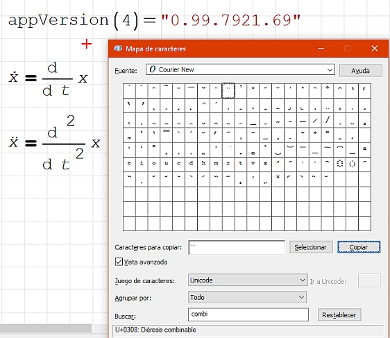

Adding on to this topic, I just came across something surprising that I can't get either Mathcad Prime or SMath to do: write a single dot or a "hat" (or caret, or circumflex accent) above a variable. This is really surprising given how common these symbols are in math from high school and college up to various engineering disciplines, and both programs exist to allow us to solve math in its symbolic "native language" as opposed to a bunch of obfuscated cell references in a spreadsheet. I've tried using the diacritical combining marks from Windows Character Map in both programs, and some of them work and some don't. I've looked through different fonts, and some, like Courier New, have more combined letters like u with a double dot or j with a caret, but I would really like to be able to match up my variables with the textbook examples for ease of debugging and for standardization for peer review. On a side note, Mathcad 15 would allow several of these characters. Any chance that this is possible in SMath with some workaround I'm not aware of, or that it could be someday? It seems like PTC really took a step backwards in going from Mathcad to Mathcad Prime in that there's a lot of things Prime can't do that Mathcad had always been able to do. This might be an area where SMath could be better than Mathcad Prime, for what it's worth.
未找到文件。未找到文件。
Thanks!
Jason

#14 已发布: 2021/10/2 23:47:17
1,139个赞,共1,805个帖子。
Hi Jason. You're absolutely right. Without a right notation, it's very difficult to solve and share the result. It is also quite frustrating to spend time and intellectual resources in the management of the units when what one wants is to ensure a reliable result that allows its review and traceability.
Try to search "comb" or "combi" in charmap, copy and paste in SMath. If doesn't work, try to open the attached SMath file, if your system doesn't fully support unicode maybe you can't see this, like what happen in my virtual windows 7.
OverDot.sm (2.65 KiB)已下载 1303 次。
Addendum: Apparently no character that has "accent" in its name can be combined with consonants. This is à ä â but x` x¨ x ^.
2位用户喜欢此帖子

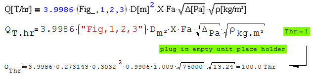

#17 已发布: 2021/10/3 11:44:09
600个赞,共1,381个帖子。
You are writing temperatures wrong.
That was discussed before in the forum.
And you are completely wrong about units.
No one will follow your unitless crusade, even you don't.
You just create your own unnecessary "silent units".
Math is unitless, science/engineering is not.
2位用户喜欢此帖子
Thanks, Alvaro. That explains the mystery of the not being able to combine F^ and k^ would both be consonants. Interestingly, while I can get x to combine with a single dot above or a double dot above, the vowel "u" will only combine with a double dot and not a single dot in any of the fonts I've tried. And I have been using the "Combining Diacritical Marks" as it's labeled on my English system, same as your "combi". It does make me wonder what my various physics and engineering mechanics books over the years were using to write out their equations since they commonly used the notation of i,j,k with the circumflex accent (hat) over them to denote unit vectors in the x,y, and z axes. I guess maybe the publisher used a custom font that had those symbols in it.
